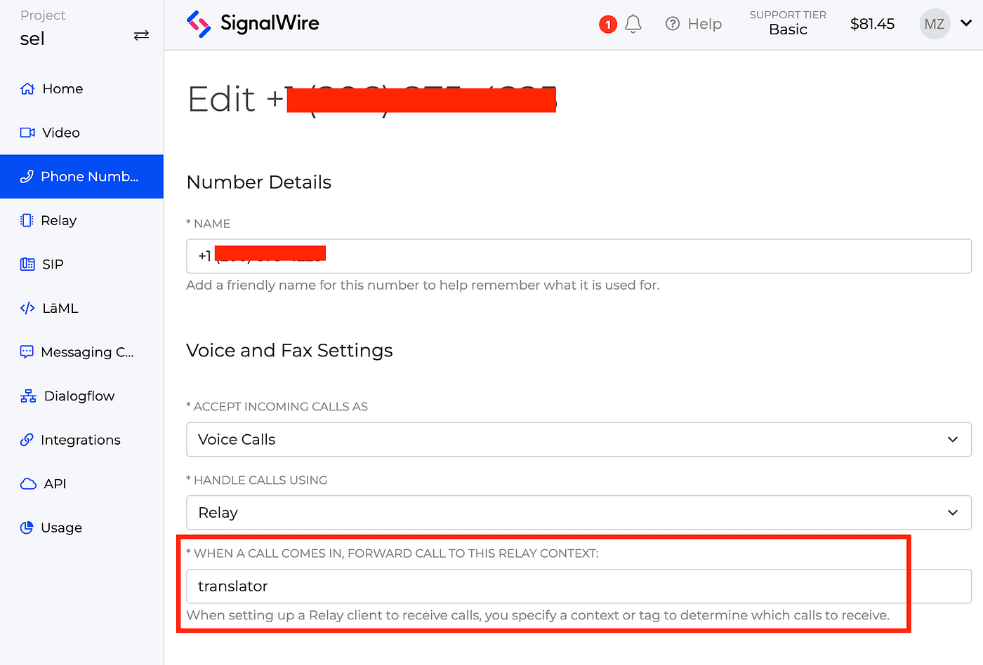

Navigate to the edit page for your newly created SignalWire Phone Number from the SignalWire Space dashboard.
Set the Relay context that your phone number forwards to as translator

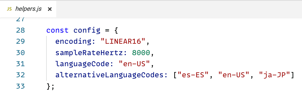

To change the languages that are detected and translated, you can alter the Google Translate configuration in the helper.js file. For a list of supported language codes see the Google Documentation. This example will detect if the caller is speaking in Spanich, English, or Japanese and translate to English.

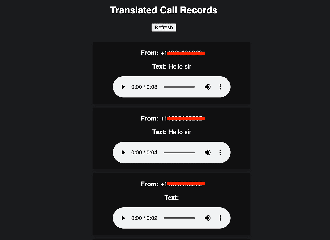

Navigating to the React App hosted in CodeSandbox will now show call records and translations, if there are any.
