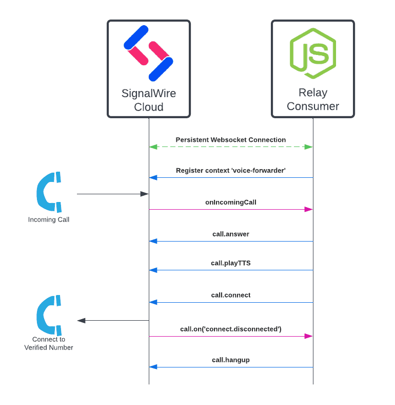

The call forwarder example uses the SignalWire RELAY NodeJS SDK to connect as a RELAY Consumer. A RELAY Consumer is essentially a client connected to the SignalWire RELAY API over WebSockets. This creates a persistent, secure connection that allows the client SDK to subscribe to events and send commands.
RELAY uses Contexts, a named string to separate events to specific consumers for specific types of calls or messages or to scale them independently.
When creating outbound requests, or configuring phone numbers for inbound requests, you can specify the context. RELAY will then deliver that call or event to Consumers that are configured to listen for that context.
The above diagram shows how this example works. The RELAY Consumer first connects to the SignalWire cloud using a Project ID and API Token to authenticate. It then registers the context voice-forwarder.

When an inbound call is made to a SignalWire phone number configured to the context voice-forwarder, the Consumer is notified.
The Consumer has a handler function, onIncomingCall, which uses the RELAY SDK method call.playTTS to play a text-to-speech message to let the caller know they are being connected to another number.

Another RELAY SDK method, call.connect, is used to command the SignalWire cloud to connect the incoming call to a verified number.

If any member of the call disconnects an event, connect.disconnected is sent to the Consumer and the method call.hangup is used to end the call.
