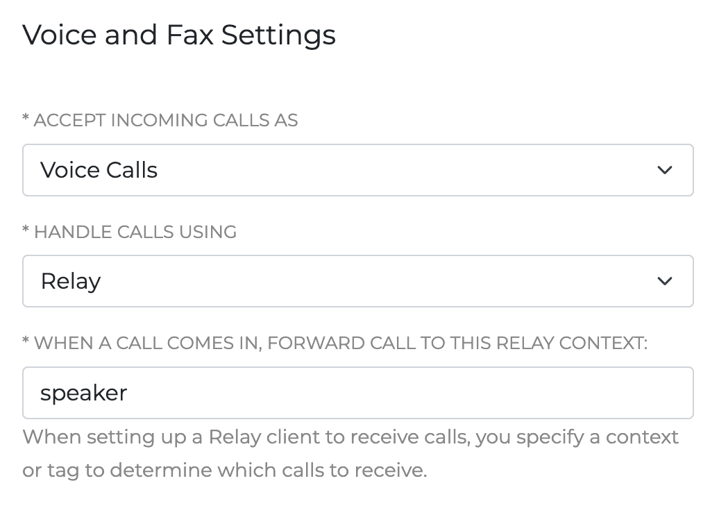

Forward calls to a context
Once your account and inbound phone number are created, you need to edit the inbound phone number to forward calls to the context used by the RELAY Consumer - in this example, speaker.
