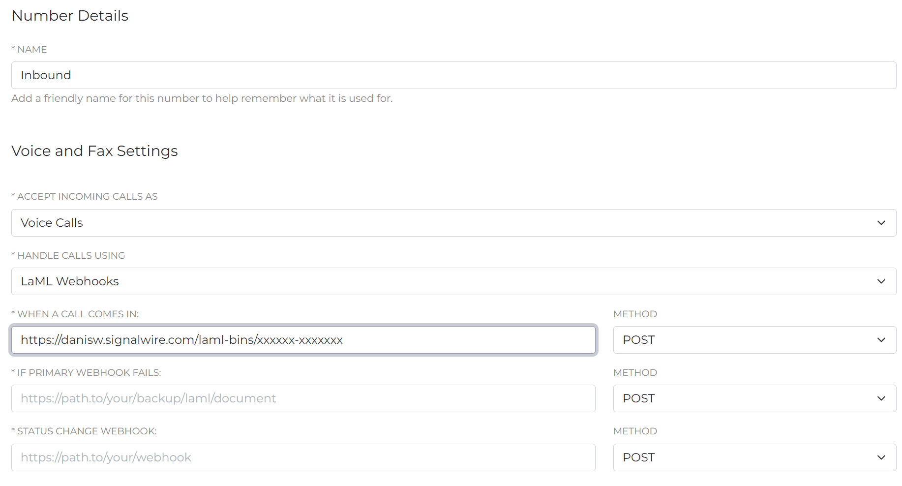

Next, you will need a phone number. Navigate to the Phone numbers tab and select a phone number to use. You can purchase a new number here at any time if you need one. We recommend searching by area code and specific strings of text. This will be the phone number you give out in place of your personal number.
Once you’ve selected the number you would like to use, navigate to Edit Settings. Handle calls using a LaML Webhook, and paste your LaML bin URL into the When a call comes in field.

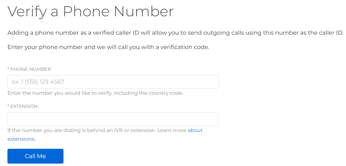

Next, verify your personal phone number. Navigate to the Verified tab under Phone Numbers. Add a new number - this will be your personal cell phone. You will receive a phone call that will give you a six digit code, which you can simply enter in the form.
Trial accounts are limited to interacting with verified phone numbers, both inbound and outbound. You can add a credit card to your account and deposit some credit to exit trial mode.
