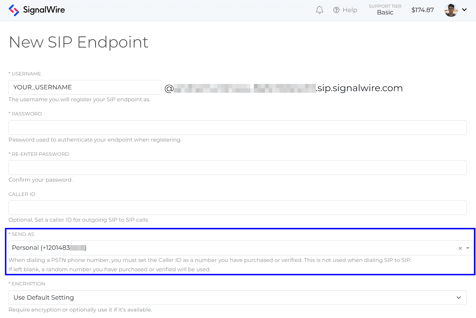

When you call a PSTN from a SIP Endpoint, SignalWire will, by default, pick a phone number at random from your list of purchased and verified numbers on that particular project. As a result, the call will display that randomly chosen number to the recipient.
Alternatively, when setting up a SIP Endpoint, changing the SEND AS setting will result in that particular number always being used when dialing a PSTN number. This ensures a more consistent outward-facing experience.

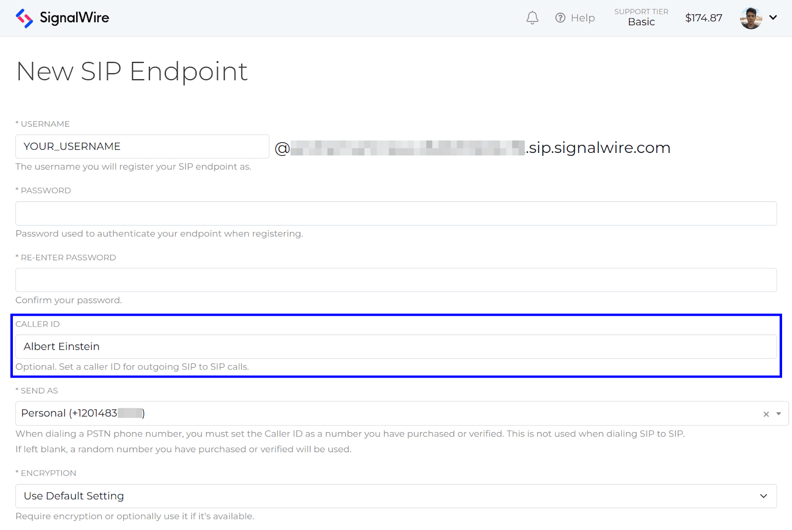

Unlike with SIP -> PSTN, the SEND AS setting is disregarded, and the CALLER ID setting is used instead. Unlike CNAM, which is not available for SIP Calling, the SIP to SIP Caller ID is not verified. Caller ID is the only way to display a name for SIP calls.
