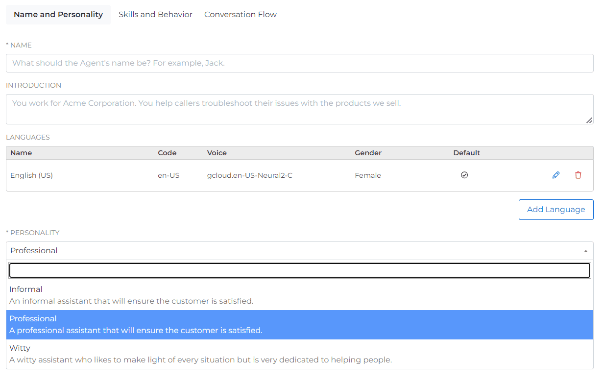

Name and personality
The opening segment of the AI agent builder allows you to define your AI agent’s Name and Personality. These selections will ultimately set the tone and context for callers’ conversations with the virtual agent.
Introduction
The Introduction acts as your AI agent’s prompt. Here, it's essential to be clear and concise. Frontloading your virtual agent with an excess of information could hinder its decision-making further along in the conversation flow.
Language
The Language module enables you to customize the synthesized voice for your AI agent. Here, you can specify a language, and in some cases, a dialect. You can also specify a gender, and choose from a selection of voices provided by Amazon Polly, Google Cloud, and ElevenLabs — many of which are multilingual.
Fillers, such as “hmm,” or “ahh,” help your voice agent sound more lifelike, and fill the dead air that can sometimes occur when an AI voice application executes a defined function or fetches information from a third party system.
Personality
The Personality dropdown allows you to choose a persona that is either Informal, Professional, or Witty. These choices are an abstraction of prompt configuration parameters, such as temperature, that define the randomness of the AI agent’s responses.

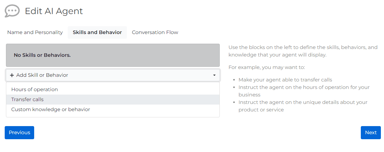

Skills and behavior
The Skills and Behavior section takes a modular approach to designing your AI voice agent’s abilities and knowledge. Rather than forcing you to write a lengthy, comprehensive prompt, these building blocks conveniently ensure that the content you supply is well-organized. This also narrows down the virtual agent’s interpretation of information supplied by the caller.
Tokens & data map
Unifying these modules is a Data Map that enables your AI agent to answer specific questions and execute pre-programmed functions, like transferring calls. By analyzing keyword patterns within the data map, these skills and behaviors ensure tokens – the bytes of information processed by the AI agent – are used appropriately.
In delivering precise, on-demand information, an AI virtual receptionist elevates a caller’s experience above that of traditional IVRs, ensuring interactions are quick, concise, and meaningful.
Hours of operation
One component of knowledge is the Hours of Operation module. If you have regular business hours or temporary holiday hours, you can quickly and easily make sure your AI agent is up-to-date on giving callers the correct information.
Transfer calls
The Transfer Calls module enables your virtual agent to reach PSTN numbers and SIP endpoints. Listening for keywords — like “Sales” or “Support” — callers can instantly connect with live representatives.
Custom knowledge or behavior
Custom Knowledge or Behavior supplies the AI Agent with info about your products or services. When callers inquire about a specific offering, your AI voice agent will provide an accurate and detailed response.

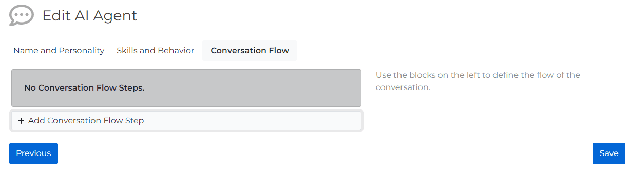

Conversation flow
The Conversation Flow is the blueprint for voice interactions with callers. By outlining the steps to a phone call — a warm greeting, a kind offering, and a thoughtful closing — you shape the caller’s expectations and introduce a certain level of conversational conformity to each unique interaction.
Behind the scenes, SignalWire’s AI agent builder formats your written instructions in a numbered list using Markdown, focusing the virtual agent’s considerable power of perception on the task at hand.
