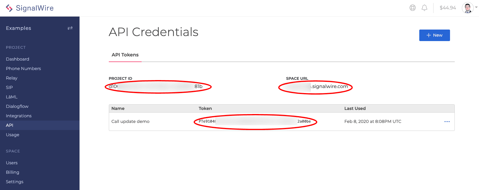

Getting your SignalWire credentials
Head to API in your dashboard and create a new token. Take note of the Project ID and token and keep it on hand for later.

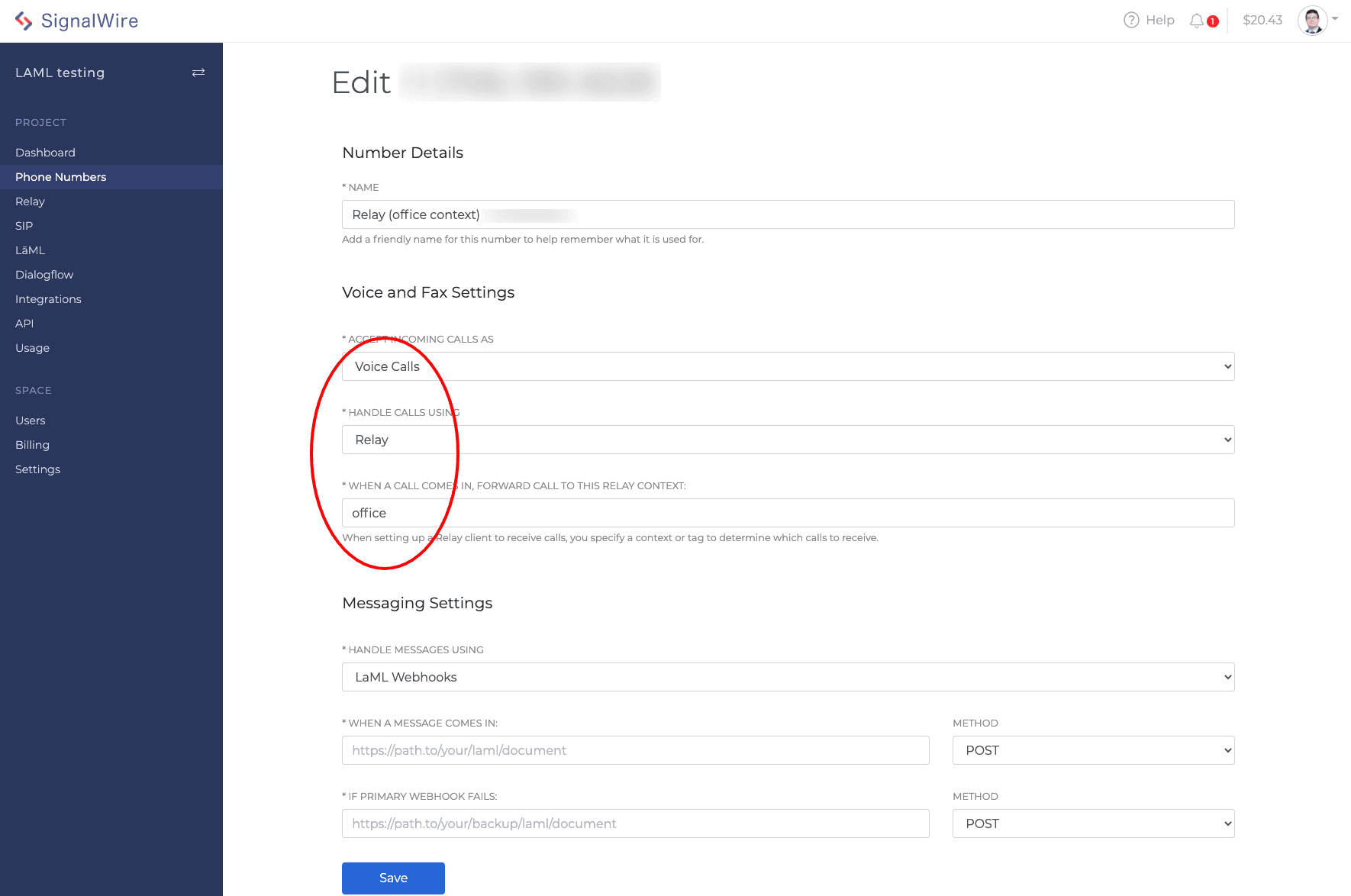

Get a phone number
You will also need to set up a phone number to handle a call with Relay. Purchase a DID from the SignalWire dashboard, select "Relay" as the handler, and input office as the context.
