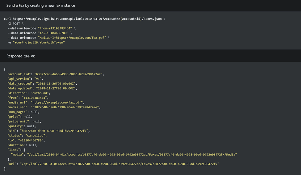

You can get started with sending a fax by running a curl request as shown below:
To begin faxing in the cloud, you need to have a SignalWire Space, which will provide you with a ProjectID and the ability to create an API token, which you will then use when calling the Fax API.
