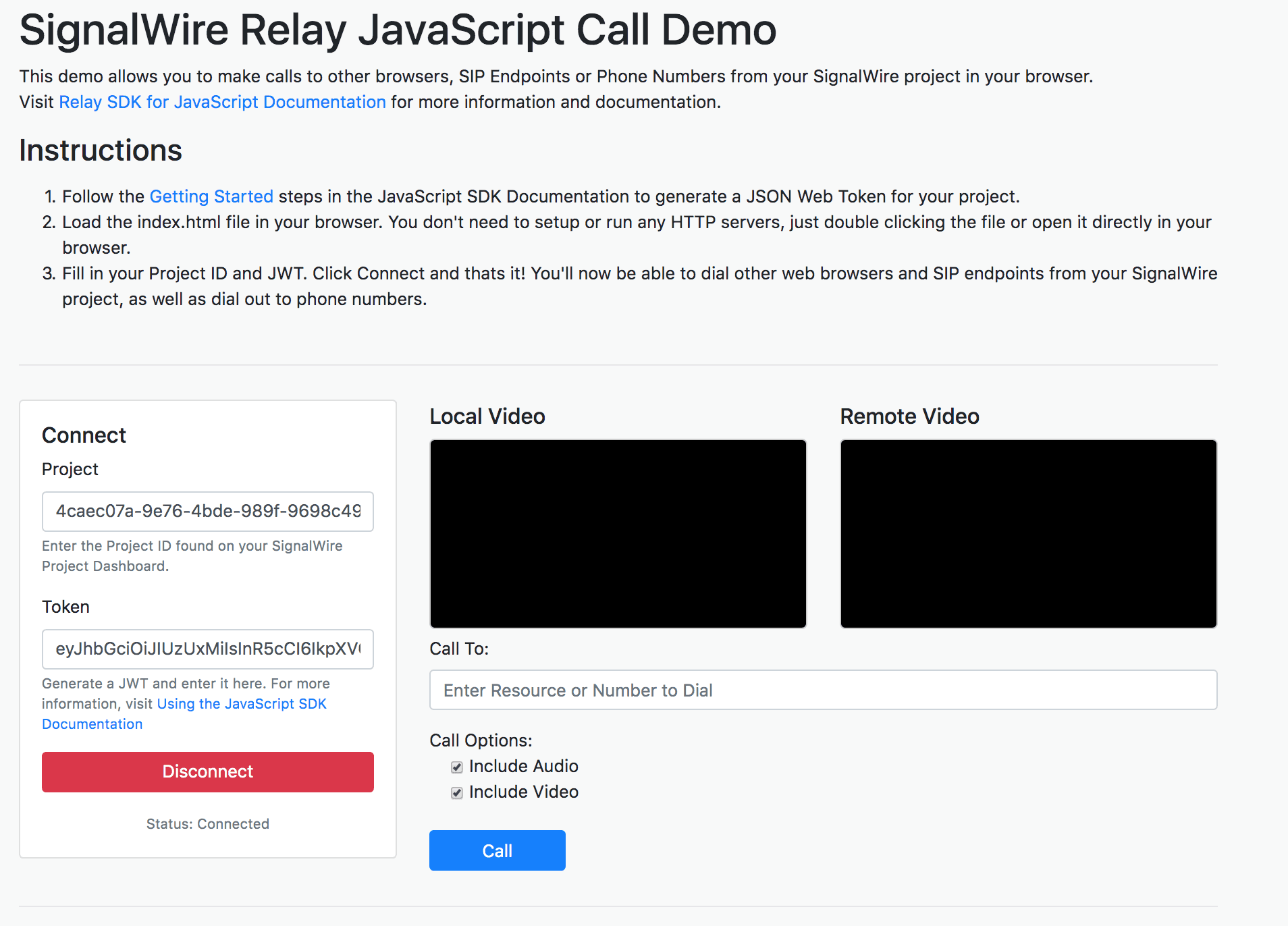

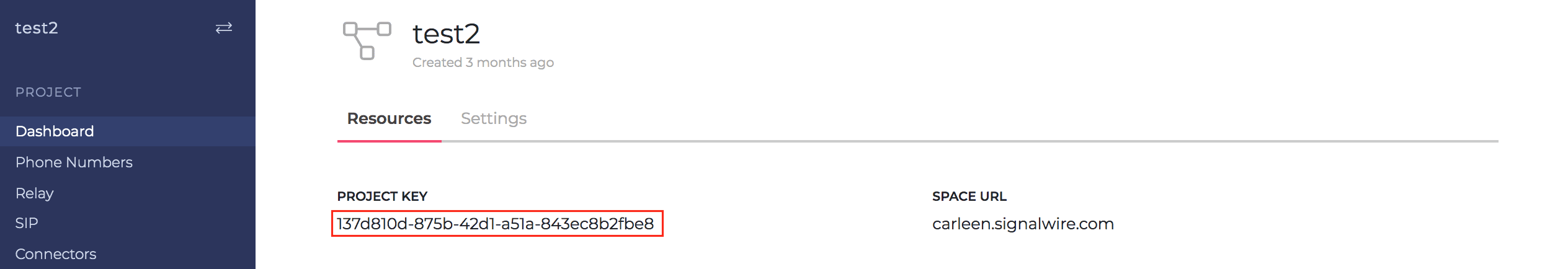

Use our demo application to test your configuration from your project. The SignalWire Call Demo can be found here. To get started, we need to grab our Project Key from our SignalWire dashboard:
Paste it in the SignalWire Call Demo under Project. We also need to obtain a JSON Web Token (JWT). To learn more about generating and using JWT, including all of the options that are available to you, see our Authentication for JavaScript SDK Documentation.
Once you have generated a JWT, copy and paste it into the demo application under Token.
After you have entered both values, connect the client by clicking Connect:
Now you can create and receive voice and video calls to and from other browsers, SIP endpoints, and the PSTN (Public Switched Telephone Network). For outbound calls, simply enter the resource or number to dial in the Call To section and click Call!
