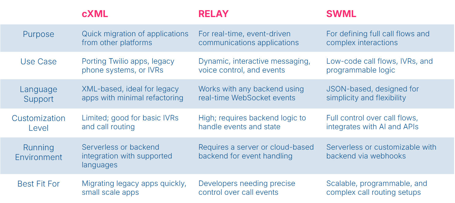

How to choose between SWML, cXML, and RELAY
Ask yourself these questions:
  1. Are you building an AI-powered IVR or call flow? → SWML is the best choice.
  2. Are you migrating a Twilio app or legacy IVR? → cXML is the easiest path.
  3. Do you need real-time event handling and backend-driven logic? → RELAY is the way to go.
Each of these tools serves a unique purpose. Whether you’re a developer looking for full control, a business migrating from a legacy provider, or a team wanting to build an AI-powered IVR, SignalWire provides the flexibility to build the right communication experience for your needs.
