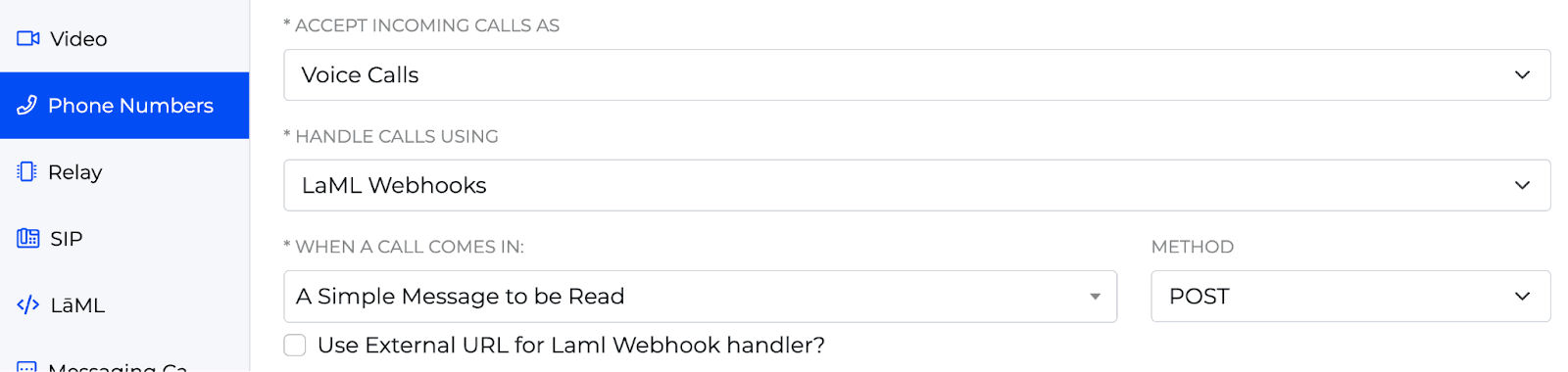

To start, make sure that your SignalWire phone number is properly configured to handle inbound voice calls using LaML webhooks. A webhook is an HTTPS request sent to your web application when a key event has occurred. Creating a LaML bin will generate an accompanying URL endpoint that you’ll later associate with the field labeled When A Call Comes In.

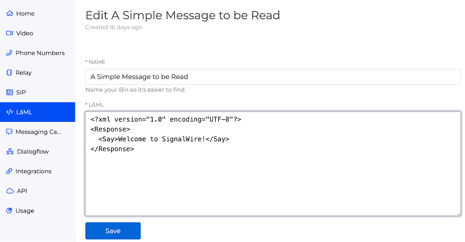

Next, navigate to the LaML section of your space. There you can create the bin that will house the logic for your text-to-speech. In this scenario, the text written between the <Say> tags will be read aloud to the inbound caller.
Once you’ve written a short greeting and saved your bin, return to your phone number settings and select the bin from the dropdown menu associated with When A Call Comes In. Save your phone number settings and try dialing your configured phone number. You should now hear a synthesized voice respond with something like, “Welcome to SignalWire!”
