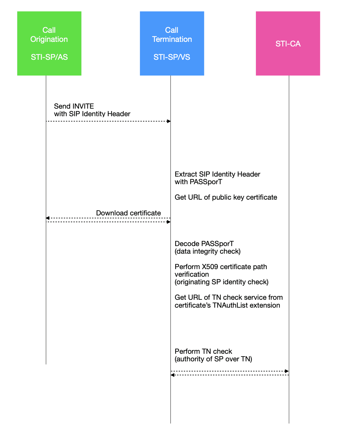

Service Provider "B" wants to check calls signed with SHAKEN, to be able to display to their users information about authenticity of the caller (trusted, fake, etc.).
SP "B" doesn't need STI Certificate, but must obtain a root certificates of the CAs it trusts. When PASSporT is retrieved from the incoming call, the link to the STI Certificate of the originating SP (say, SP "A") is dereferenced and PASSporT's signature is verified against the public key of that certificate.
Additionally, the certificate itself is subject to X509 certificate path verification procedure, which checks if the chain of trust can be established between that certificate and one of trusted anchors (CAs).
Service Provider "B" wants to implement (run) STI-SP/VS service.

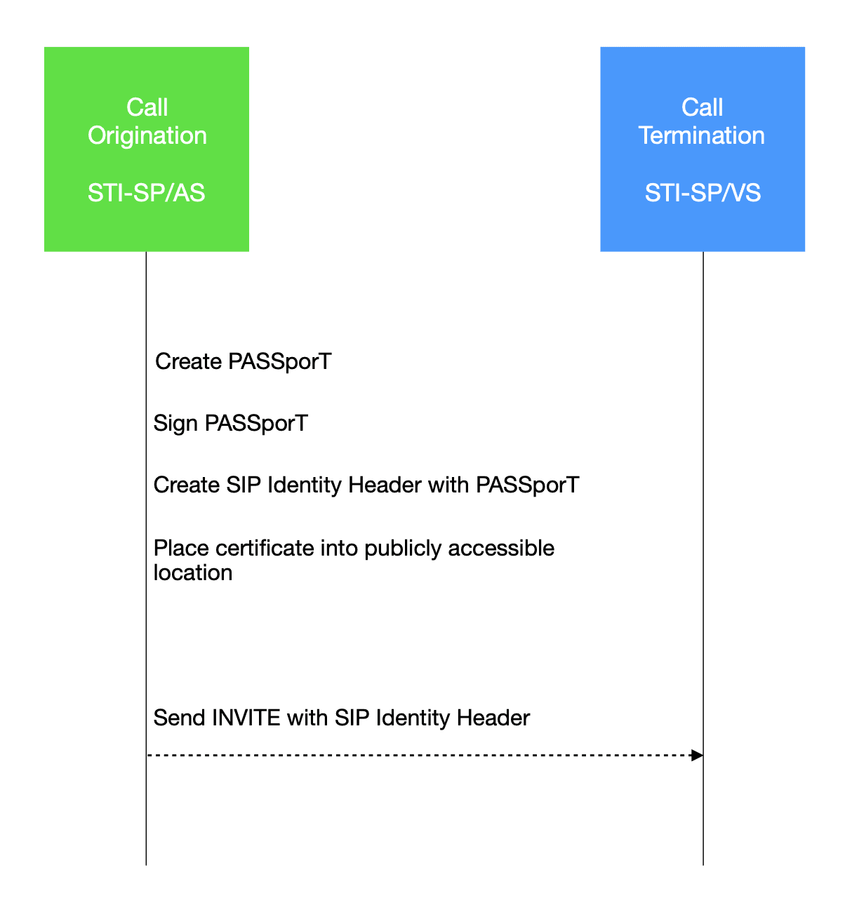

STI-SP/AS: Call authentication
The authentication service is using JWT (JSON Web Token) for signing the call (creating PASSporT) with the SSL key of the Service Provider.
A1. Obtain a STI SP certificate from Certificate Authority.
A2. For every call STI-SP/AS create JSON Web Token (PASSporT) with call data (Caller ID, attestation/trust level for the call, and a link to SP’s public certificate).
A3. Sign PASSporT with STI-SP’s certificate.
A4. Add this to the SIP through SIP Identity Header.
