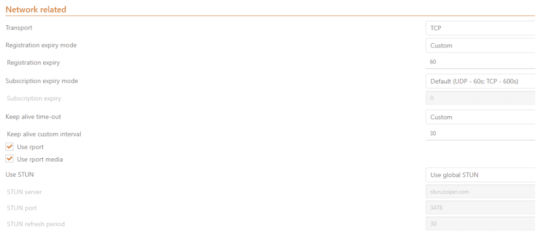

You can skip the ‘Optional: Authentication and Outbound Proxy’ step if desired - it is not necessary. When asked for a Transport Method, choose TLS. You should now see a green checkmark next to the SIP endpoint in your Zoiper window, indicating you're ready to make calls!
If you are having trouble getting your endpoint to authenticate, go to Advanced Settings and check to make sure your settings match the below photo.
